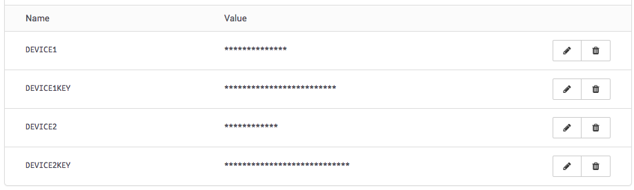

  • Using the resin.io dashboard, store the simulated device IDs and keys as environment variables for the gateway device:
The first task of start.sh is to check for these device credentials. It also does some checks to make sure the display is properly configured:
